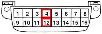

Post by rené » 04 Jul 2007 5:38
d'apres mes infos l'odb2 n'est pas fonctionnelle en 95 /
1995 - Revised Optispark. J55 Heavy Duty Brakes made standard. No other major changes. Last year of ZR1. OBDII hardware installed, but not fuctional.
1996 - Last year of C4. Special editions: Collectors Edition, all silver with either grey, black or red interior; GrandSport, 1000 made, all came with Admiral Blue paint, white stripe, red hashmarks on front left fender, black ZR1 style wheels, rear fender flares (coupes only), interior black or red/black - All GrandSports were LT4/6spd cars. All manual cars came with LT4 (330hp), automatics came with LT1. ODBII fully functional.
donc le cable aldl que je propose est à priori fonctionnel pour 95
en 95 normalement tu sors les codes en mettant un strap ici (pins 4 et 12)
